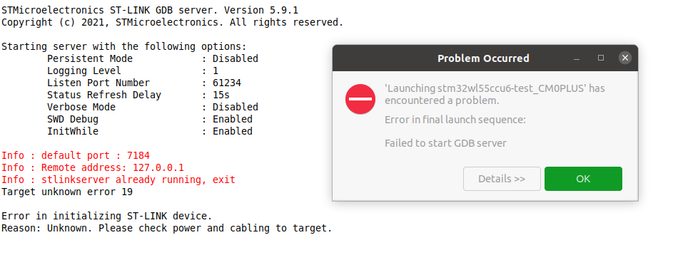

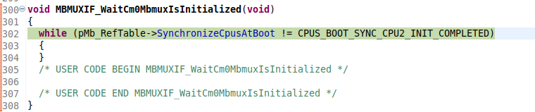

I started my project from scratch in CubeIde. So just select stm32wl55ccu6, choose all necessary peripherals and lorawan. Unfortunately, from scratch, this MCU can't choose only one core option(M4). To be able to use the Lorawan option, I need to IPCC turn it on. I created the project successfully.
I stuck here
_legacyfs_online_stmicro_images_0693W00000GYgPL.pngI found a similar problem on this forum.
https://community.st.com/s/question/0D53W00000VgqmvSAB/trouble-with-the-stm32cubewl-dual-core-example-projects
Of course, I can't debug Cortex M0.
But it doesn't work in my project. I replaced ***.ld and ***.s files for M0. Would you please reproduce it and give me some hints on how to start Cortex M0 core?
