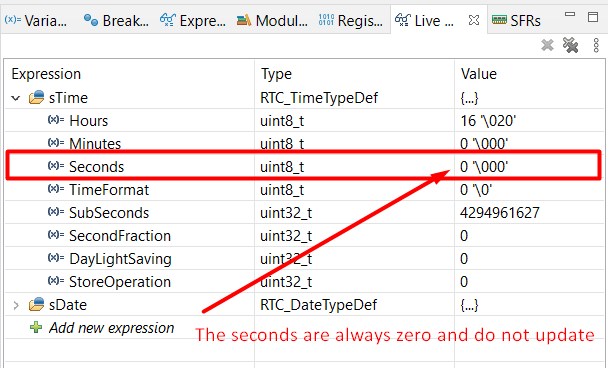

My problem is that the time does not update and the seconds are always 0 as shown in the image below.

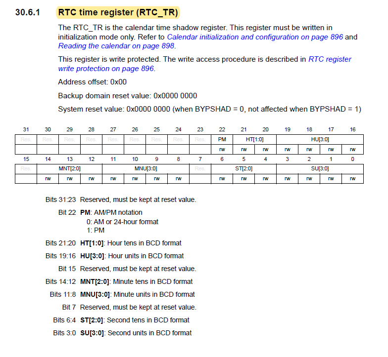

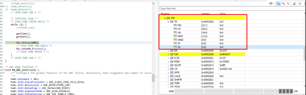

I set a break point in HAL_Delay and I just realized that the RTC_TR register does not update at all after each tripping. Any advice?
Also the LoRaWAN_End_Node example enables the bypass shadow register. Should I reset the RSF bit of RTC_ICSR register?

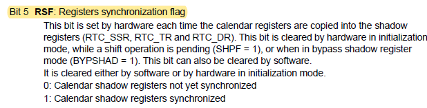

Hello @Nikosant03 ,
To read the calendar through the shadow registers after calendar initialization, calendar update or after wakeup from low power modes the software must first clear the RSF flag.
The software must then wait until it is set again before reading the calendar, which means that the calendar registers have been correctly copied into the RTC_TR and RTC_DR shadow registers.
The "HAL_RTC_WaitForSynchro()" function implements the above software sequence (RSF clear and RSF check)
I hope this help, let me know if this solve your issue.

You are right sorry,
You don't need to use this function, it's only used when shadow is enable.
The difference came from the End_Node project is not based on Systick but on TimeServer , unlike the RTC_Calendar example.
Anyway you can use the functions located in Utilities/stm32_timer.c which will basically do the same job as the functions from HAL to handle time and calendar.
