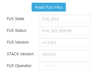

FYI - I have successfully been able to upgrade the FUS version with no issue:

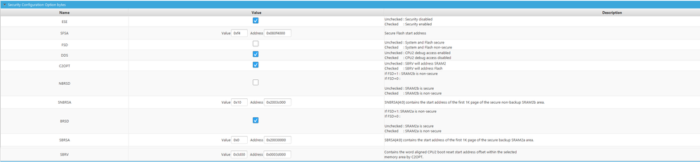

Not sure how to export the options byte (incase they are useful information here) so some guidance on that would be appreciate also.

Regarding the option bytes, just do a screen shot of the secure ones. That should be enough.

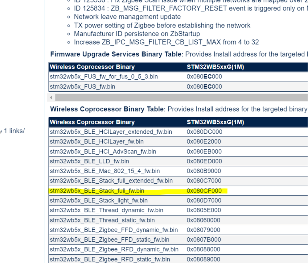

Does this solution mean that the address given in the documentation (release notes) is just wrong? This is what I was working off of:
Device info:

En effet c'est étrange. quelle est la version de WB FW package utilisez vous? V1.13.x ou v1.14.0?
‎2022-09-28 8:02 AM
Apologies, it seems I was reading the V1.14 notes but trying to flash the V1.13 binaries. Thanks very much for your help I think this is closed now :)
