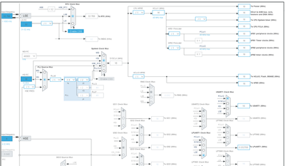

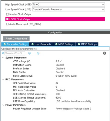

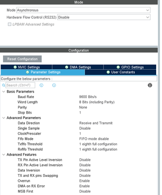

Hello folks,when I was using the HAL library function to implement MCU wake-up service from STOP2 mode through LPUART serial port, I found that no matter how the data was sent, the MCU could not exit STOP2 mode. Below are the relevant configurations configured by my cubemx,the MCU I am using is STM32WLE5CCU6.

Could you please try to refer to the LPUART_WakeUpFromStop2_Init example (don't forget to read carefully the readme file). This should guide you on how to implement the wake-up throw LPUART from STOP2 mode. You can then migrate the same process on your MCU.

I just referred to the official routine and took a small section of the code for the first wake-up, but my test results showed no response. The wake-up callback function HAL-UARTEx-Wakeupcallbacks seems to have not entered.
Could you please try to review if the message is well transmitted to the LPUART from the source (maybe you should review it throw the oscilloscope). If it works fine, you can follow the example I've recommended and try to implement your config based on the config on this project.
