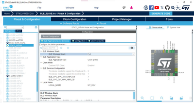

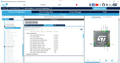

Hello Team,

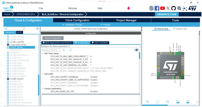

I am Priya from Illuminen Technologies working as an Embedded Software developer. We are working with STM32WB55CGU7 BLE controller for our application. We need to use this module as client and server with two individual modules. And also we need to pair the client and server modules and find the distance. We are trying server application and its run and shown the name in ST BLE TOOLBOX app and its connected with this app successfully. But we are trying as client application there is no reaction in module. I will share my configuration, help me to resolve the issue.
Here above is our sample BLE client application sample configuration.
Above our sample configuration for your reference. And is there any need to change in configuration in CUBEMX or in these files of app_ble.c and p2p_app_clint.c files. How to handle these files can you give me a guidence for to resolve the issue. Thanks in advance.

Hello @PRIYA_En
First, sorry for my late reply. I suggest you take a look at the BLE_p2pClient where you can understand how the Client side of the application work. Also, I suggest you take a look at the Client description on the STM32WBA Bluetooth® LE – Peer 2 Peer Applications - stm32mcu that will give you description on how this works. Finally, the AN5289 will always be the reference to build any STM32 BLE application specially paragraph 8.4.4 and 7.5.
