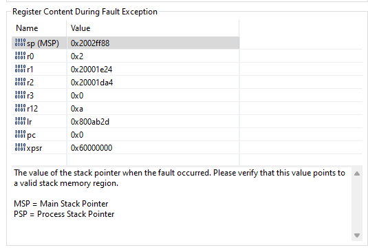

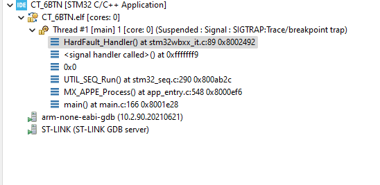

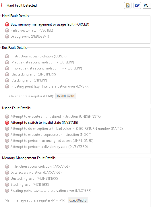

As soon as client makes connection with server, client device go to HardFault_Handler.

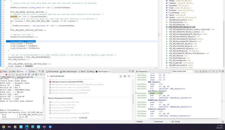

I tried debugging
problem is some where in function UTIL_SEQ_Run
local_taskset = TaskSet;
local_evtset = EvtSet;
local_taskmask = TaskMask;
local_evtwaited = EvtWaited;
I have not modified anything other than the Button press->start scanning-> find my device -> connect.
I am stuck at this point can some one please help me with this!!!

Did you start from BLE_p2pClient example available in STM32CubeWB package? If it's not the case, where did you register your task?
