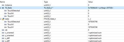

Debug variables before BSP_TS_GetState(0, &TS_State); error:
My problem is that get to HardFault_Handler(void) from the file stm32h7xx_it.c just after executing the following line:
stm32h735g_discovery_ts.c:
if(Ts_Drv->GetState(Ts_CompObj[Instance], &state) < 0)
Debug variables before Ts_Drv->GetState(Ts_CompObj[Instance], &state); error:

Ok, so debug the Hard Fault, look at the registers (processor) and code (disassembly)
Suggestive that TS_DRV isn't a valid pointer, INSTANCE is out of range, or STATE pointer isn't valid
Add some sanity checking.
If calling from Interrupt or Callback, check pointers/handles being passed in.
Perhaps get a HardFault_Handler() that outputs actionable data.
