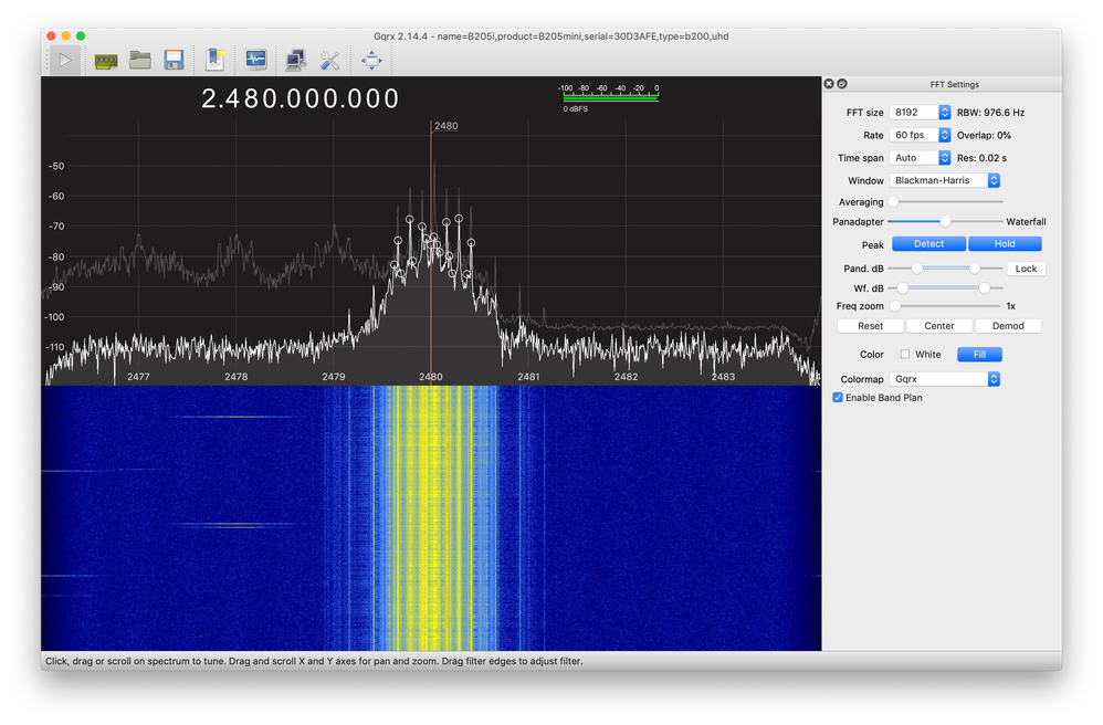

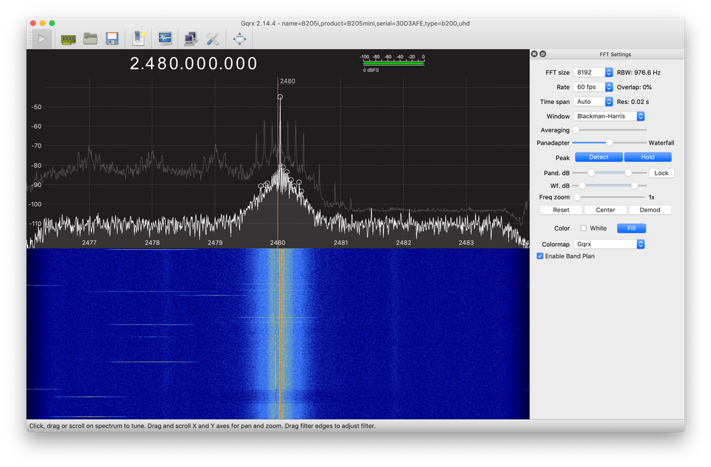

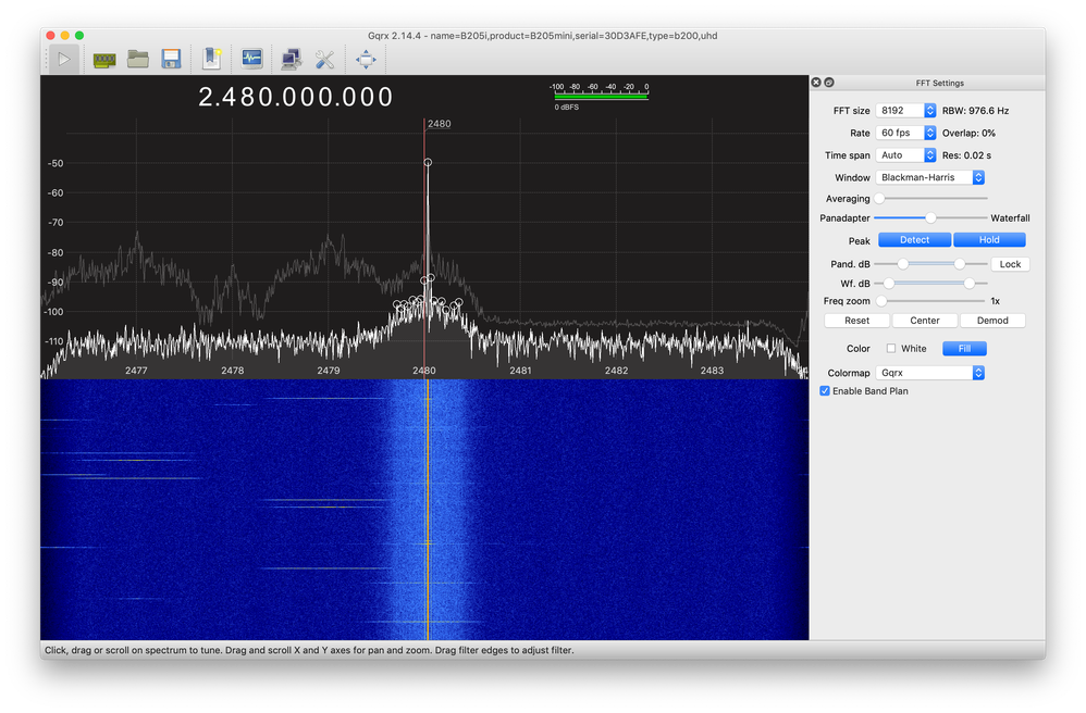

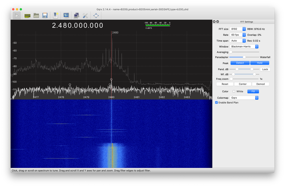

‎2021-09-24 1:28 PM
Can you capture a picture of the spectrum around the channel frequency used for the communication?
The question behind is whether the DC-DC converter is impacting the power or the RF area via spurious harmonics.
‎2021-09-25 4:59 PM
Those are previous test samplesThose are new:
Packet test is failed, there is a small spikes after Carrier Test that can be seen, and then silence.
