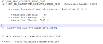

Hey.
I'm currently working on BLE Client and peripheral to make a connection and communicate some sensor values. However, whenever there is a connection request made by client and a successful connection is established, immediately I see BLE_DISCONNECTION_EVT and the connection breaks.
Based on the debug message, the reason for connection failure is returning the error code as 0x3E, which translates to "Connection failed to be established". Can you help me out this?
Attaching the snapshot of the debug messages.
