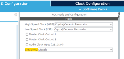

AScha.3
did you set the lse+hse in Cube ?  and flash this program then ?
otherwise cpu running on internal clock only.

Hi AScha.3
Thank you for response.
I'd tried connect to my board with STM32cube but STM32cube can not access my board.

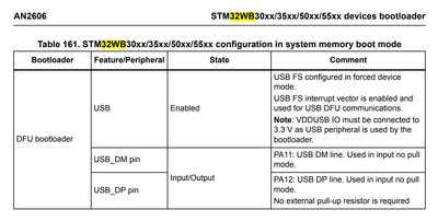

Hi MM
I'm using STM32CubeIDE(ver 1.13) and microUSB 5pin cable, not use STlink.
Hi AScha.3
Thank you for your interest.
I'm not using STlink, connect with microUSB 5pin cable.
Boot pin is connected at GND.
Your choiced bootloader load isnt native suppoerted in IDE. You need handle load sw manualy or over script. Too you cant debug with this setup. Why you choice this?
