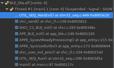

Ok it looks like it just needed a power cycle. After following more or less the above process, I can write to the reboot request char and get the app to reboot into the OTA app. I can even debug the OTA app and catch the point at which it jumps into it after the reboot request, but it never seems to advertise as STM_OTA. The OTA app and not the user app is clearly running though. What am I missing?
2023-07-15 7:29 AM
So when I issue the reboot command and it jumps into the OTA app, it seems to hang here. It's just idling waiting for an event it appears, so it never exits SHCI_C2_BLE_Init(), which means it never makes it to Ble_Hci_Gap_Gatt_Init(). Is this a bug in the OTA app or does this mean I haven't commanded the reset correctly somehow?

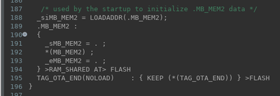

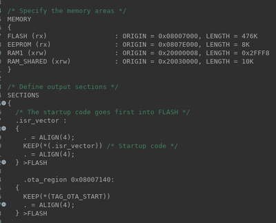

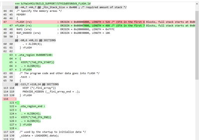

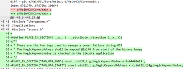

What is missing from your description and probably also from your code is the magic number used by the OTA application to verify that you have a good Firmware.
2023-08-07 8:12 PM
2023-08-07 8:25 PM
While I'm at it, here's the relevant sections from other parts of the code as well:
