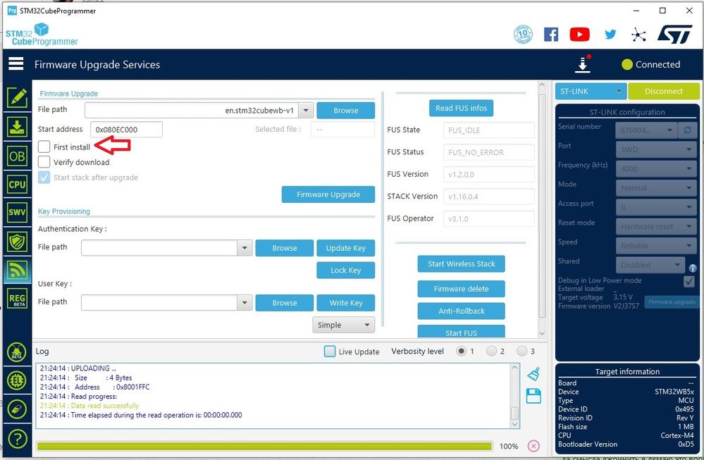

Hello all)
To work with BLE I need to upload
stm32wb5x_BLE_Stack_full_fw.bin
with address
0x080CE000
via STM32CubeProgrammer
It works as well, I did it many times, if check the box first boot for stack
but I forgot (and not first time) to do that and now my BLE doesn't work on one of my devices
I made full chip erase, reuploaded stake, removed stack, and installed again dozen times via STM32CubeProgrammer, I did all can via  STM32CubeProgrammer (probably)
but it doesn't work anymore.
Why STM32WB so capricious in this situation?
Does it exist any opportunity to erase the chip to factory settings with the stack as well, let's say a more hard option than provided in  STM32CubeProgrammer ?

RonilAuthor
September 3, 2024
To start using BLE I need to upload the stack in STM32WB
As you can see in my attached image from the first message I did it but forgot to make a mark - "First Install"
and now No matter what I do ( full chip erase, reuploaded stake, removed stack, and installed again), Bluetooth doesn't work
STTwo-32
September 3, 2024
I suggest you to update the FUS and Stack again but dont forget to click on "Start wireless stack" button after that and before disconnecting from CubeProgrammer.

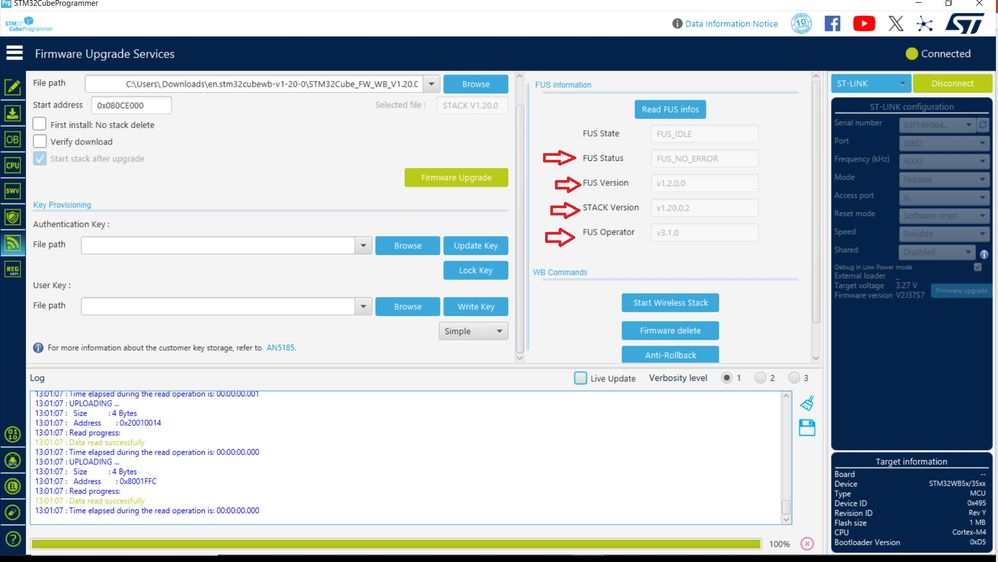

STTwo-32
RonilAuthor
September 17, 2024
Hi @STTwo-32  I added the settings for my BLE, Would it be helpful?

Explorer II
August 7, 2025
Any updates on this? Facing the same issue here
