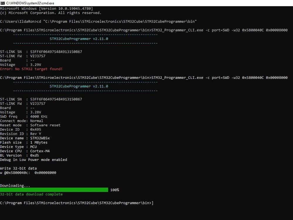

Hello all)
To work with BLE I need to upload
stm32wb5x_BLE_Stack_full_fw.bin
with address
0x080CE000
via STM32CubeProgrammer
It works as well, I did it many times, if check the box first boot for stack
but I forgot (and not first time) to do that and now my BLE doesn't work on one of my devices
I made full chip erase, reuploaded stake, removed stack, and installed again dozen times via STM32CubeProgrammer, I did all can via  STM32CubeProgrammer (probably)
but it doesn't work anymore.
Why STM32WB so capricious in this situation?
Does it exist any opportunity to erase the chip to factory settings with the stack as well, let's say a more hard option than provided in  STM32CubeProgrammer ?
Hello @Ronil
Could you Perform a factory reset to restore the device to its default state. This can be done by writing the value 0x00008000 to the address 0x5800040C. Then, update your FUS and install the Stack.
Best Regards.
STTwo-32
Hello, thank you so much for your support.
According to your advice - I used the next command
STM32_Programmer_CLI.exe -c port=SWD -w32 0x5800040C 0x00008000
and it looks like that
Actually, I am not sure that "restore the device to its default state" was successfully performed since, via "STM32CubeProgrammer," I still see that data was not erased from device memory, and Stack and Fuse are still the same.  Can you conform that it as ok?
I uploaded again many times FUS and Stack but BLE is still not visible.

Everything Should be fine. Could you give me a description of what you do for Stack and FUS upgrade (step by step if possible).
Best Regards.
STTwo-32
Yes, of course,
two-way
first, via STM32CubeProgrammer connect
1.1. Connect with the board
 upload stm32wb5x_FUS_fw.bin to 0x080EC000
and after
1.2. upload stm32wb5x_BLE_Stack_full_fw.bin to 0x080CE000
1.3. Start wireless stack
1.4. Upload Hex file
1.5. Disconnect with STM32CubeProgrammer and Reset MCU
and via STM32_Programmer_CLI.exe did the same, without the result
also I tried
and full chip erase via  STM32CubeProgrammer
Start FUS STM32CubeProgrammer
remove stack and upload as first time via STM32CubeProgrammer
Options byte

Have you tried to upload one of our ST Example. It may be a problem on your firmware.
Best Regards.
STTwo-32
Hi, yes, I did it a few times, without a result. Actually the same problem I had and in STM32WB Nucleo board
Could you please check what is the content of the address 0x5800040c.
PS: Are you using the Version 2.17.0 of the Cube Programmer. If no, please update it and repeat the same configuration for FUS and Stack.
