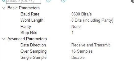

I've been trying to make connection with STM32F0 Discovery and hc-06 bluetooth module via USART2. I've configured Discovery as shown on figure below. Additionally there is an nvic interruption. Hc-06 is configured the same way as Discovery.
uint8_t bluetooth_recive = 1;
HAL_UART_Receive_IT(&huart2, &bluetooth_recive, 1);
I've checked hc-06 if it's passing values sended form app on smartphone. App I was using was Bluetooth terminal HC-05. I was sending ASCII code. Connected hc-06 via usb_uart converter
was passing values to computer's application Realterm.
So my question is if there is a configuration problem or something else..

Hard to say, try sending data, and checking with a scope. Check other board rates, or getting the module in to AT command mode.
Make sure the TX/RX sense of the pins is wired correctly. That the output on the HC06 goes to the input on the STM32
Check functionality of the HC06 using a USB-to-CMOS Serial converter, and interact on a PC

There is no communication problem with HC-06 via AT commands. Pins are double checked. I will try now communicate with borad/pc with different configurations.
MMaj.1
Okay, I changed interruption type. Now I am using DMA, which unexpectedly works...
