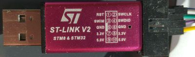

dam74
I'm using V2.18.0.
Here's the STlink I'm using with STM32F103 also.
It semes that you are using a clone ST-LINK V2, so we can’t guarantee that it will work fine. Please ensure that you are using a genuine ST-LINK V2 to guarantee that it will work fine. More details are available in this article.
