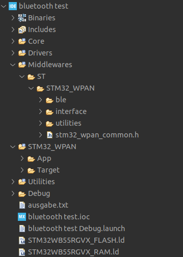

Yeah exactly what i was looking for ._. i always trusted google in successfully searching Github but nevermind. Anyway this leads to a followup Question. Why isnt this part of the middleware included when I am configuring a project in the CubeIDE and what option should i possibly enable to get it. I enabled all the necessary Subsystems and the RF module and the STM32WPAN and selected BLE. Maybe u can help me with that as well :)

Hey,
i have the middleware and the STM32WPAN just the ble_lld folder is missing and doesnt get included when the cubeIDE is generating code
Mike_ST
They are not included because the Low Level Drivers are probably not needed for the project and/or the option is not available in CubeMX to include them.
In case you need them, please add them manually.
