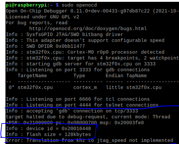

Also did you checked Openocd?@Mickaël JEAN​
If the flash size is the same maybe your "device id" is different, you could code a bash script that flashes different code depending of the chip detected
