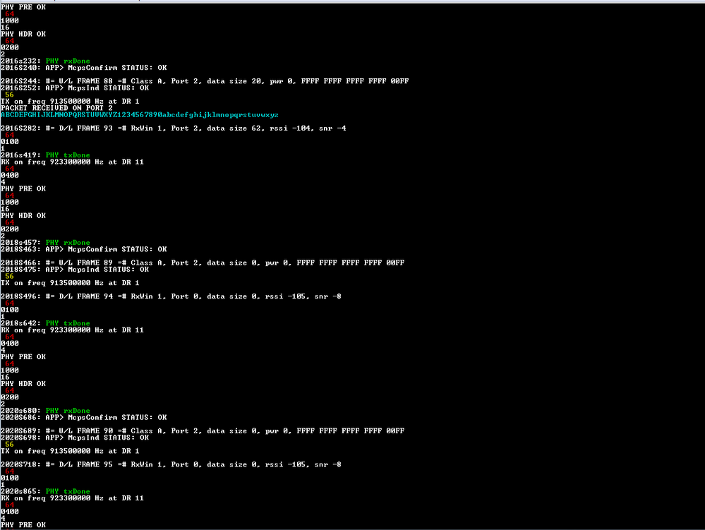

Hello there,
I have sx1262 Lora module from nice RF.
In ABP mode I can sand data on TTN but during down link time node always send me Rx time out.
Here I am attaching my logs. please guide me .

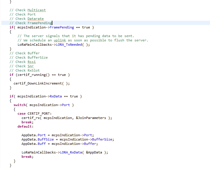

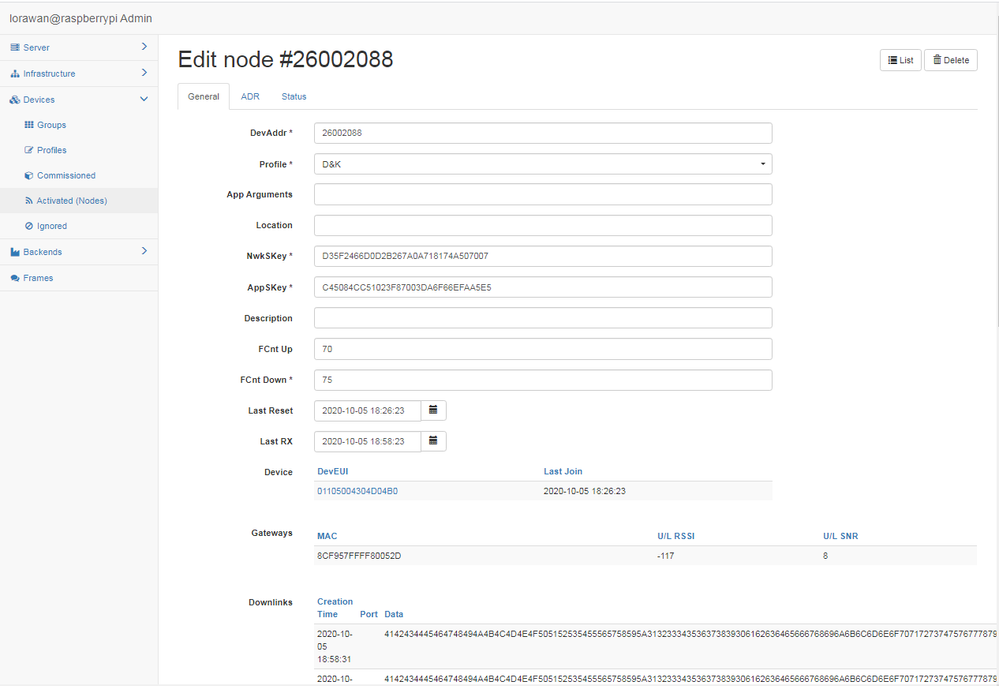

Hello @Remi QUINTIN​ ,
Thanks for the reply, I got RX done in my code when changes the RTC Configuration but still some time I am facing RX Time out, Can you please guide in stack at which point Rx timer start for receive window?
I am facing 1 more problem when on my server there is a multiple down links are there at that time i am receiving only first frame. other frames are flushed. I noticed that during that time continuously LORA_TxNeeded function is calling. Can you please guide me to solve this issue.
Here I am attaching my log screen short .
Thanks

Remi QUINTIN
The Lora Sw I am working with is not supporting your platform (L4 + sx1262 Lora module).
I am looking for someone who was involved on the I-CUBE-LRWAN project to help you.
Grep or find-in-files RxTimeoutTimer, typically in the Radio BSP code
STM32CubeExpansion_LRWAN_V1.3.1\Drivers\BSP\Components\sx126x\radio.c
Indicative of it not completely receiving any data during window.
The timeout must include reception time of packet, it can fire mid-data.
Watch for dead-time when you aren't receiving/listening for traffic, watch particularly what you waste time on after "TxDone"
Could be that it is simply not seeing any data on the frequency/channel you've picked, make sure the radio is configured to the right place to see the transmitted data. Dump the registers, double check.
