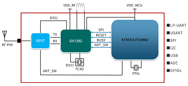

Looks to be the same microcontroller (STM23L072), but with SX1262 instead of SX1276:
I-CUBE-LRWAN already claims support for "the new generation sx126x" 
There's also Semtech's own drivers:
SWL2001 - LoRa Basics Modem Library
SWSD003 - Code examples for SX126x and LR11XX
SX126x driver
via: https://www.semtech.com/products/wireless-rf/lora-connect/sx1262

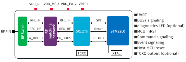

For reference, this is the block diagram the old Type ABZ module:
It seems that this is now NRND (Not Recommended for New Designs).
