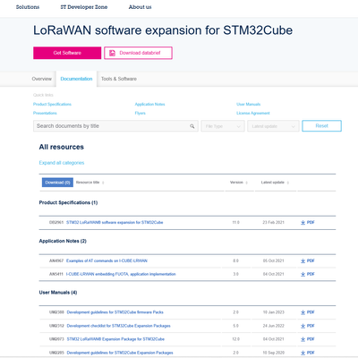

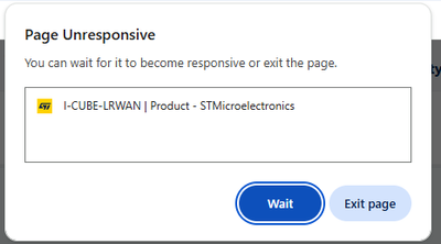

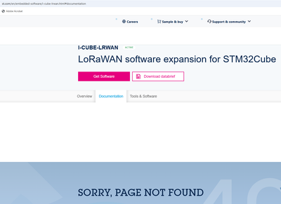

Hmm, there should be documentation on the Product Page - but it seems to be broken at the moment:
https://www.st.com/en/embedded-software/i-cube-lrwan.html#documentation
Is there a PDF included in the download?
@mƎALLEm
I can see the documentation content:
Not here - Win-11 Chrome :
Also on Edge
Same config but I don't have the issue! maybe you need to close Chrome and restart?
