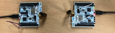

Hello ST experts,
I hope this message finds you well!
I am writing to request your support for a project involving the Nucleo-WL55JC. I have successfully communicated between two Nucleo boards using RF communication with the SUBGHZ protocol (not LoRa).
However, I have encountered difficulties in establishing communication with other RF devices.
Could you please assist me in developing an application -similar to the ping-pong example- that can scan RF signals within the range of 150 MHz to 980 MHz?
Here you can find the last post.
@STTwo-32
Many thanks in advance for your support.
Best regards,
Zayoud

What do you mean by "scan RF signals"?
Do you just want to see if there is any RF activity at all at each frequency?
ie, just measure RSSI at frequencies between 150MHz and 980MGHz?
Like a spectrum analyser?
yes, like a spectrum analyser, to have a physical vision of radio frequency communication to analyze and find threats in this communication.
So something like (pseudocode):
set starting frequency;
REPEAT:
   measure rssi;
   set next frequency;
UNTIL all frequencies done
Yes, I think that's the main idea of the app. We could also include features like scrolling and checking other settings like modulation rate and carrier frequency in the program.
Also, If we scroll through the frequencies like that, will it cause an error? (initialization issues).
Hello @Zayoud
For such an application, I suggest you use two Nucleo-WL55jc one for the High band (Nucleo-WL55jc1) and the other for the Low band (Nucleo-WL55jc2). For each one, you have to set a list of frequencies that you want to check the activity. Then implement a switching mechanism to check the activity on each frequency (following the solution proposed by @Andrew Neil ).
Best Regards.
STTwo-32
