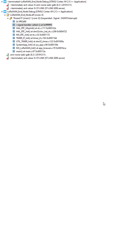

Running a program on the stm32wl nucleo board works fine, but if I enable debugging it alwaus crashes. This does the same thing on my custom board. It's always the same signal handler

Look at VECTACTIVE bits to determine what interrupt it's in. Then determine why it's in that interrupt and why it's not where it should be.
Ensure SCB->VTOR is pointing to the correct place.
