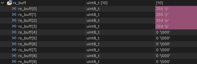

I am trying to set up a nucleo-wl55jc1 to send UART data to a custom pcb I made. I will post both IOC files as well as the necessary code to help. I can send data one way (from the pcb to the nucleo) but the other direction, is not working.

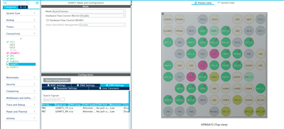

IOC file for nucleo, I am using usart1 for communication between boards, and usart2 for coms to PC for debugging.

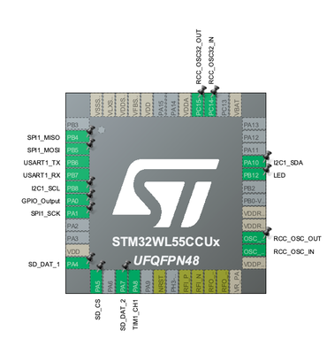

IOC file for custom hardware. Note that the uart pins were initially for the STLINK, however, due to some design changes, they are being used to communicate between boards.
Here is the code for the receiver that just runs in main. Using the live expressions I can see the data coming in.

Viewing the Live Expressions for the RX Buffer I can see
But the new data isn't coming in every 5 seconds and the RxBuff seems to randomly update with random values every once in awhile.
