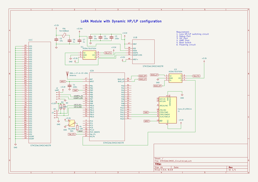

Hi @STTwo-32 ,
     I have designed the schematic for STM32WL5MOC. Could you please kindly review it and let me know is there anything missing in this. I am planning to start design the PCB for prototype. So I want you to review once before I proceeding next with next step. I have designed with Kicad.
I have attached the pdf format as well. Kindly review and let me know is all the components are appropriate value.
Questions:
1. SMA-J-P-H-ST-EM1 antenna connector being used in MB1779 board, I am using the same in my design as well. But I feel the connector itself more expensive, its pretty much 50% of total module cost. Is there any alternative option do you suggest to reduce the cost?
2. in the above schematic I didn't use the pi circuit between pin no17 and the  SMA connector. I assume its not required since referred in the expansion board manual UM3127. Kindly correct me if I am wrong.
3. I didn't captured the LDO circuit in this assume I have 3.3V output getting from LDO and connected here. Is there any extra isolation required between different 3.3V lines mentioned in this schematic.
4. Is my debugger port connection are looks good? Hopefully I can use STlink V3 debugger?
5. Is my I2C and UART port are looks good ? here I would connect a I2C sensor and using UART for serial communication with another Micro(STM32U599VJT6)
Looking for your Valuable Feedback,
