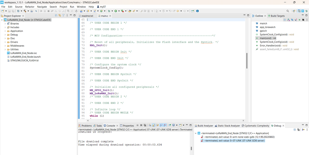

Dear All,
I am sharing the log from STM32cubeide and STM32cubeprogrammer. I need your help to figure out what went wrong. after debugging
I face this problem of not being able to connect to stm32wl. So I "full chip erase" is only option, then I being able to connect. Using ST Link V2 and STM32WLxx MCU.
I'm just using these toolchain for 1 week only.

STMCubeProgrammer Log:
11:01:04 : UR connection mode is defined with the HWrst reset mode
11:01:04 : ST-LINK SN : 13002900130000544141514E
11:01:04 : ST-LINK FW : V2J42S7
11:01:04 : Board : --
11:01:04 : Voltage : 3.25V
11:01:04 : Error: No STM32 target found! If your product embeds Debug Authentication, please perform a discovery using Debug Authentication
