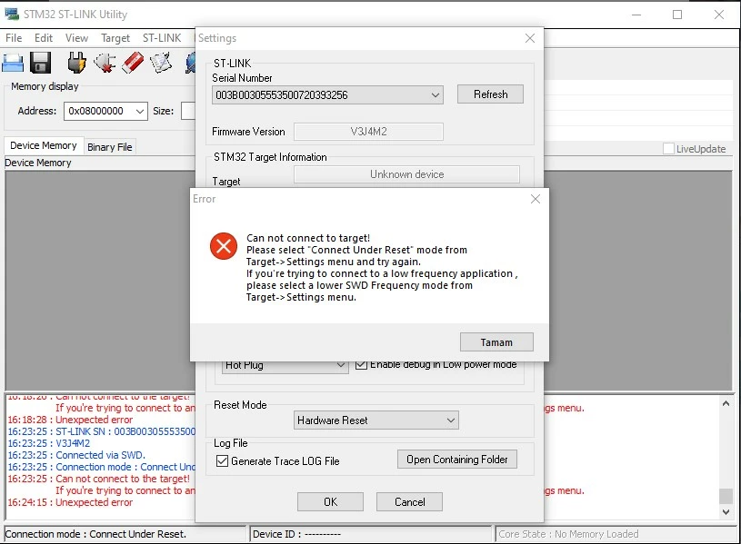

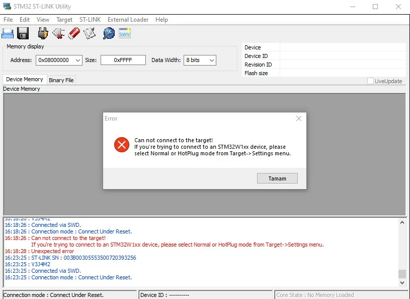

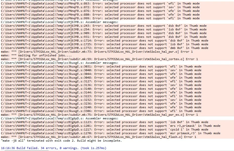

0693W00000GWTIiQAP.jpg0693W00000GWTQQQA5.jpg0693W00000GWTPhQAP.jpgHello there. I have the NUCLEO-WL55JC1 board. But I couldn't get it to work. The errors I get when I try to connect to ST-LINK Utility and load code in CubeMX are available in the pictures. Can you help me to solve these problems?

Hello @MKoca.1​ ,
It's recommended to use STM32CubeProgrammer for programming STM32 products that replaced the ST-Link Utility.
So try to use STM32CubeProg, then please share your progress with the community here.

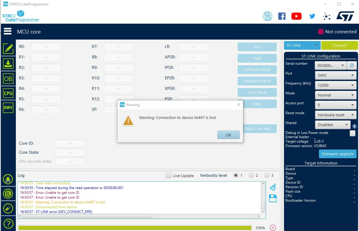

Also, when I try to run LoraWAN samples in Programmer, I get the following error.
November 5, 2021
Many reasons for such issue: USB cable, issues with power supply, or it may be linked to wrong pinout.
Try with other boards, cable to check if there is a problem with detecting the device.

It runs the samples in the "example" folder. But I am facing this problem when I want to run samples in "Applications" folder.
