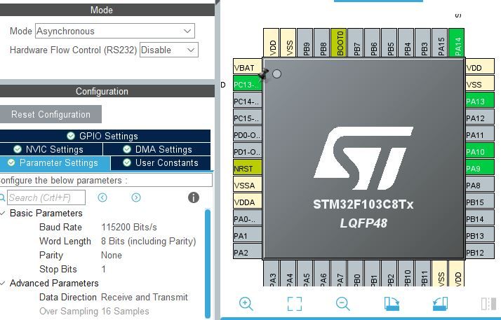

not able to perform UART communication between Nucleo wl55jc2 and stmf104c8t6
what could be the reason?

You've coded the solution incorrectly?
You have the wrong pins?
You haven't crossed the RX/TX between the micro-controllers?
The clocks are wrong?
Suggest to get a scope, and test one outputting a 'U' data pattern in a continuous loop, check the bit timing and that it's using the expected pin, etc.

Check that the HSITRIM value in the WL55JC2 is being set correctly.
‎2021-08-08 11:11 PM
thank you for your reply
the clocks were wrong
i put 48Mhz on stmwl55jc2 and 72MHz on stm32f103c8t6 then uart worked fine
‎2021-08-08 11:18 PM
wl55jc has MSI, i used MSI clock
