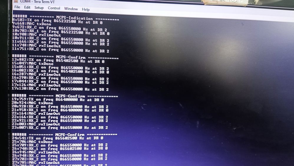

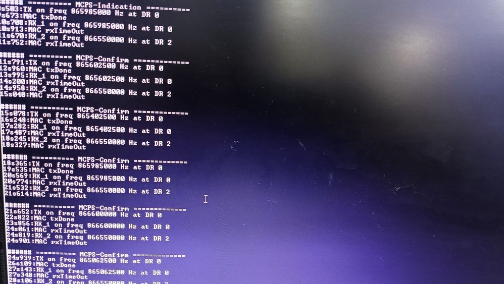

I'm trying to using/operate L072Z LRWAN1 in class c. I'm able to know that node is operating in class c( I'm attaching images below). But i want to disable the receiving window to get faster data rate.
In class A I'm getting 20 frames per minute at SF7. when i try switching to class C number of frames per minute switched to 12 per minute. As the number of frames are reducing the data rate is also decreasing. Hence i want to disable the receiving window to get faster data rate

IMG_Class A.jpg.This image is of terminal In class A.
This is the terminal image of Class C.

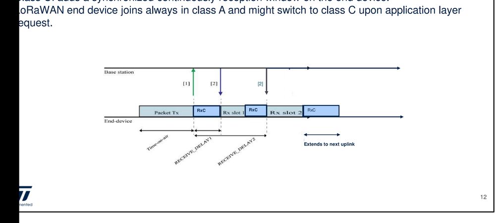

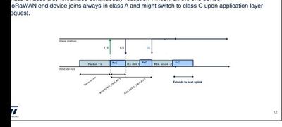

This image show the Tx and Rx sequence in Class C and it matches with terminal image for class C.
Not able to understand the sequence. Why after Tx, RxC,Rx1,RxC,Rx2 then RxC?

The definition of Class C says:
"Class C – Lowest latency, bi-directional end-devices:
In addition to the class A structure of uplink followed by two downlink windows, class C further reduces latency on the downlink by keeping the receiver of the end-device open at all times that the device is not transmitting (half duplex). Based on this, the network server can initiate a downlink transmission at any time on the assumption that the end-device receiver is open, so no latency."
https://lora-alliance.org/about-lorawan/
Disabling the end-device receive is going to break that!

@Andrew Neil Thank you for the response.
1) I want to disable receiving window, So that my node does not have to wait for downlink from gateway and node will continuous send packet(Tx).
2) Higher data rate means higher then Class A. When i operate in Class A I'm getting 20 frames per minute at SF7.
When i operate at Class C i only get 12 frames per minute at SF7.
Class A mechanism : Tx->Rx1->Rx2 then next frame. Were as Class C mechanism: Tx->Rxc->Rx1->Rxc->Rx2->Rxc and this is taking more time then class A. hence i want to disable Rxc and Rx receiving windows.

But, again, that breaks the specification for Class C!
