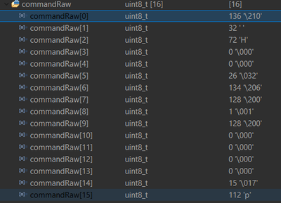

I'm transmitting a custom packet by the NUCLEO-WL33CC2 and I'm receiving the pachet by a different harware that use the SI4460 tranceiver from Silabs. In the receiver board I receive the pachet, but the byte are completely differents than the byte I sent. Look like as the STM32WL33 have applied a coding, but I do non have applied any coding on the transmetter.

 in the receiver I have these data:
How can I solve?
I have tested the NUCLEO-WL33CC2 and my receiver by the STM32CubeWiSE-RadioExplorer and I can send and receve the correct packet.

I solved the problem! Was a wrong configuration in SyncLenght. I wrote
MRSUBG_PacketSettingsStruct.SyncLength = 16;
 But the reference manual wrote:
so to get 16 bits in syncronization word I need to write the SyncLenght parameter 15 value. So simply writing
MRSUBG_PacketSettingsStruct.SyncLength = 15;
  solve the problem.
