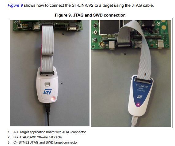

I am using LoRa-E5 mini board from seeed studio (https://www.seeedstudio.com/LoRa-E5-mini-STM32WLE5JC-p-4869.html)
To program it using STM32CubeIDE, do we need to connect it to pc using ST-Link or we can simply program it via Type C cable?

Hi @FBrin.1​ ,
Sorry for the delay to answer you, as this period is very busy for me with many tasks.
You need to connect the ST-LINK to a target using the SWD cable as you can see below.
You can check the SWD pins connections in the UM1075, Table 4. JTAG/SWD cable connections.
0693W00000Bb2vXQAR.jpgI hope this helps !

Hello @FBrin.1​ ,
Connect the STM32WLE5 board to the computer with a USB cable type C to the Type C port for power and serial communication, and connect another micro USB cable to the ST-Link side to the SWD pins.

FBrin.1
Thanks Imen,
Can you please clarify this part : "connect another micro USB cable to the ST-Link side to the SWD pins."
Where can I get this ST-Link cable?
Hi @Imen DAHMEN​
Which ST-Link cable should be connected to SWD pins?
Will this work ? https://www.adafruit.com/product/2548

FBrin.1
Thanks @Imen DAHMEN​
Will this be compatible? https://www.adafruit.com/product/2548
Yes, it is compatible. You can use it.
