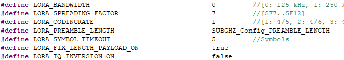

I used a GFSK configuration with 433MHz and it is work very well,
I try now to migrate to Lora modulation. i used a basic config, but the receiver on the other side receive less then 1% of sent frames ! (even transmitter and receiver are very close)
is anybody has advice to improve communication ?
malarab
Senior II
finally i resolved the problem :
in fact, i made an application without hal drivers, just ll drivers. so, i have write my own code to interface radio drivers with subghzSPI inspired by hal_subghz.
but for some reason, it worked on GFSK modulation but no in LoRa modulation.
finally, i implemented hal_subghz file and necessary definitions to run it, and it is working done :)

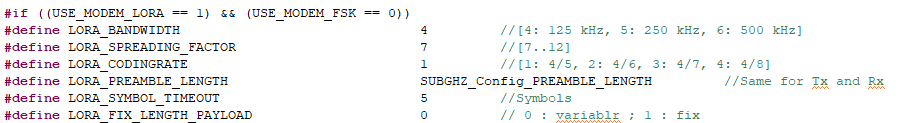

last update after multiple debugging :
1 - when i set fix payload length in tx and rx config, i have a crc error in detected frame, i detect wrong data, than a hardfault.
2 - when i set variable payload length, i don't have the hardfault, but a cannot detect all frame (less then 1% are detected) and when i detect, i usually have a header error
i set the same config for the transmitter and the receiver.

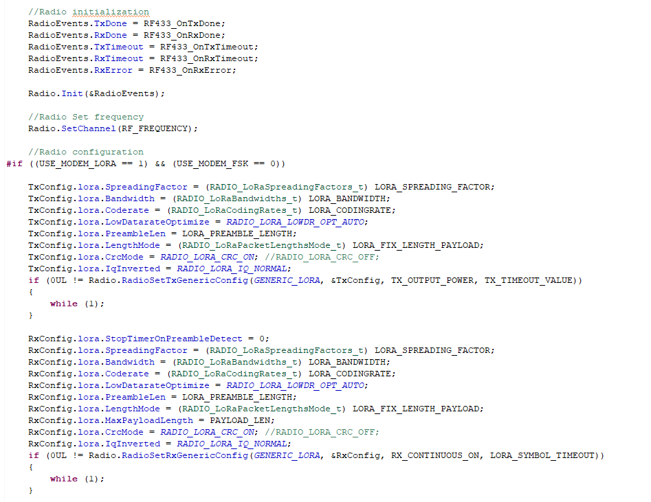

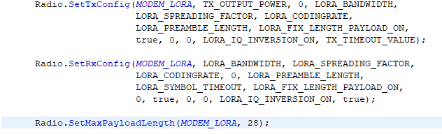

malarab
Senior II
I tried to configure lora modulation on an other way, but always the same problem !
pleas find the code below
