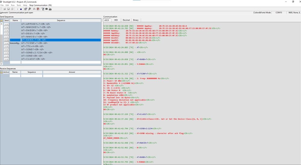

    AS i'm using LORA-E5(stm32wle5jc) module communicating point to point Radio Frequency and AT Command also. We are config SubGHz for Radio Send and Receive Functions in Loop Mode . No Response received from this.  By using AT command we need to flash any Binary Files? How to Communicate P2P Two Lora-E5 module.

Hi sir,
     In case We are using AT Command, We need to flash any binary Files for STM32WL series.

Hello Sir,
  We are using Example SubGHz_Phy_AT_Slave Replaced my User Board (stm32wle5 modules) AT commands works well.  But now i communicate P2P communication using AT commands two lora-e5 module is possible?.
If it is possible to communicate P2P Using AT Commands What are all the config we need to proceed. plz guide me to proceed further.
