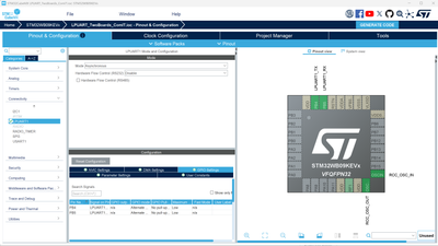

I am testing UART of NUCLEO-WB09KE with the board [STM32WB09 Nucleo-64 board (MB1801 and MB2032)]
I Set UART1 PIN PB4, PB4 with the source attached[100ms period tx send ].
I am checking CN3(23), CN4(35) but no signal shown.

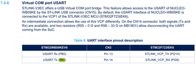

Laurent LOUAZON
Agree the best is to start from an original code from ST such as <UART_Print>.
I just built and flash it inside Nucleo-WB09.
I am able to connect with an hyperterminal (picture below) set as explained in readme file of this example (Data Length = 7 Bits, One Stop Bit, Odd parity, BaudRate = 115200 baud, Flow control: None)
Are you able to have the same?
Also when you mention you do not see signal of CN3:14.
Are you talking about CN3:14 of MB1801?
Be careful, on MB1801, PA1/PB0 can be accessed on CN3.35 and CN3.37

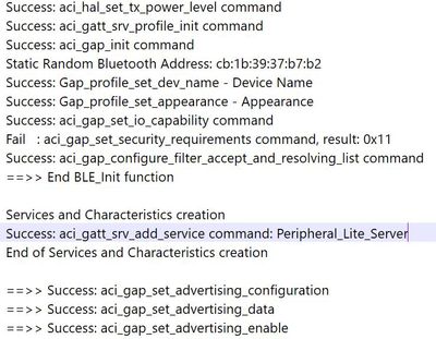

But I found something.
with <BLE_Peripheral_Lite>[C:\cgu\ble\stm32cubewb0-v1-4-1\STM32Cube_FW_WB0_V1.4.1\Projects\NUCLEO-WB09KE\Applications\BLE\BLE_Peripheral_Lite]
There is uart output on CN3.37
messege is "Success: aci_hal_set_tx_power_level command ....."

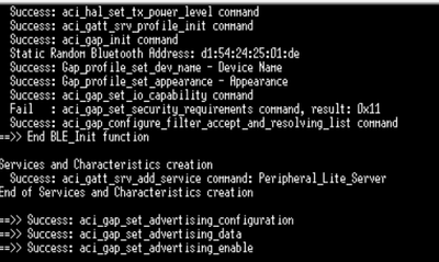

Laurent LOUAZON
Just tested as well BLE_Peripheral_Lite and I can see below message on CN3.37
So if this works on your side, no reason, this should not work for UART_Printf FW.
Have you used our default binary provided for BLE_Peripheral_Lite FW or did you rebuilt it?
I guess you had no choice to rebuilt UART_Printf as we do not provide default binary for this one.

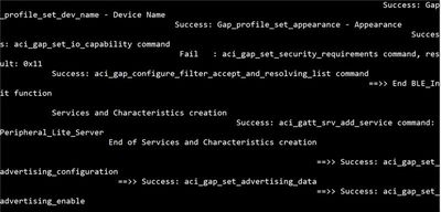

@Laurent LOUAZON  It is same as I have got.
I tested with rebuilt binary.
