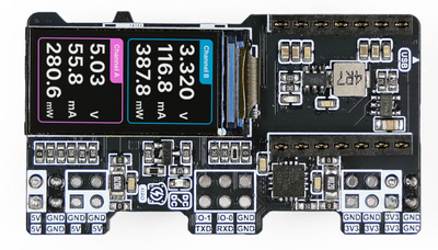

When I measure the current using a Xiao PowerBread, I get around 20 mA on the 5 V rail, even when the MCU enters Sleep Mode.
On a related note, I would be careful with such a device.
Said Xiao board uses a 13-bit ADC for current measurement, which gives you an accuracy of about 1/8000 of the full range at best. And you find very little about accuracy and tolerances in the specs.
Check the user manual of your board, many ST eval boards have an IDD jumper you can remove, and attach an ammeter for measuring the current of the MCU section.

@Mariiian09 wrote:
I measure the current using a Xiao PowerBread,.
You mean this: https://www.seeedstudio.com/XIAO-PowerBread-p-6318.html ?
As @Ozone suggested, that's not going to much use in this type of application.
The current consumption in this type of application is very "peaky" - you're not going to get anything useful by just looking at displays.
Not even with a proper multimeter.
What you need is something like the STLINK-V3PWR or X-NUCLEO-LPM01A - that will give you a proper, real-time view of the current.
I actually use one of these: https://www.nordicsemi.com/Products/Development-hardware/Power-Profiler-Kit-2
