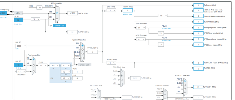

My project is SubGHZ Phy Ping Pong. In AN5568 the Rx consumption varies from 4mA to 10mA. In my project, the Rx consumption current from 8mA to 9mA. I want to reduce the Rx consumption. My configure below,
Please recommend me some solutions.
Thanks.

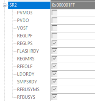

‎2022-07-07 2:56 AM
Thanks for your support.
I found the PWR_SMPS example code in STM32Cube_FW_WL_V1.2.0. This is my PWR_SR2 register.the LDO is enabled. How to disable LDO?
Thanks.

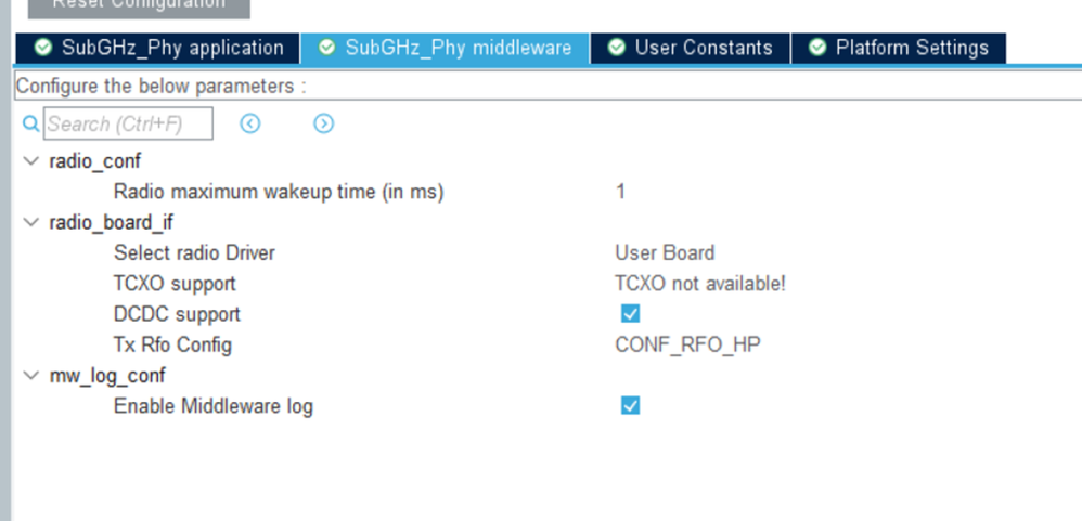

‎2022-07-07 6:33 PM
void SUBGRF_SetRegulatorMode( void )
/* ST_WORKAROUND_BEGIN: Get RegulatorMode value from RBI */
RadioRegulatorMode_t mode;
if ( ( 1UL == RBI_IsDCDC() ) && ( 1UL == DCDC_ENABLE ) )
mode = USE_DCDC ;
else
mode = USE_LDO ;
/* ST_WORKAROUND_END */
SUBGRF_WriteCommand( RADIO_SET_REGULATORMODE, ( uint8_t* )&mode, 1 );
the RBI_IsDCDC() return IS_DCDC_SUPPORTED
#define IS_DCDC_SUPPORTED 1U
DCDC_ENABLE
#define DCDC_ENABLE ( 1UL )
But LDORDYbit set when I run project.
What wrong ?
Please review for me.
Thanks.
‎2022-07-08 4:49 AM
Hello @Ngô Vạn​ ,
In fact the LDO is always on, so your flag will always be set. But if you enable the DCDC, so the power source will be the DCDC an no current will come from the LDO but it will still be mark as ready.
To know which power source is use, you have to check the SMPSRDY flag.
Best regards
‎2022-07-10 5:20 AM
I got it. Thanks for your support.
