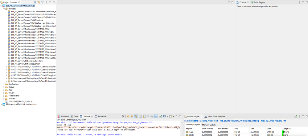

I have gone through this example several times and when I try to compile and run the code it prompts some errors and I am unable to execute it.
‎2022-11-16 5:46 AM
Specifically this message:
make: *** No rule to make target 'C:/Users/Utilities/lpm/tiny_lpm/stm32_lpm.c', needed by 'Utilities/stm32_lpm.o'. Stop.
‎2022-11-16 6:38 AM
Looks like a makefile/IDE config issue. Is this a CubeIDE project? That path looks like it is outside your IDE project path, unless your entire project is under C:/Users/Utilities.
If using CubeIDE and want this code compiled as part of your project (as opposed to a separately compiled library), it needs to be in/under your project directory, like this:
C:/MyProject/src
C:/MyProject/lpm
‎2022-11-16 11:30 PM
I have solved the path issues but still error exists. Here is the screenshot.
‎2022-11-17 12:32 AM
Can you try with the latest STM32CubeWB package (v1.14.1) and the latest version of STM32CubeIDE (v1.10.1)?
