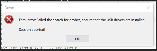

My board has STM32WB55RE on it. I have developed the code from STM32CubeMx.
I am trying to program and debug via IAR workbench I am getting this error 0693W00000JNR2QQAX.pngI have JLink v7.54a software installed. I opened the Jflash and tried to connect the target. It is connected and programmed successfully but the application didn't run.
The signals at SWD connector on my board
VTar - 3V
Gnd - 0V
NRST - 3V
SCLK - 0V
SWDIO - 2.5V
I tried another setup; I used SWD lines(ST-Link) from the Nucleo WB55 board to my board and did the program and debug. I was successful. I could see that the application is running. This confirms that the SWD lines on my board are correct.
With this setup,
VTar - 3V
Gnd - 0V
NRST - 3V
SCLK - 0V
SWDIO - 3V
How can I enable JLink for my board?
I see a difference of level SWDIO 2.5V and 3V in two different setups. Is this causing this problem?
