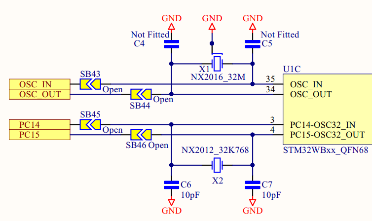

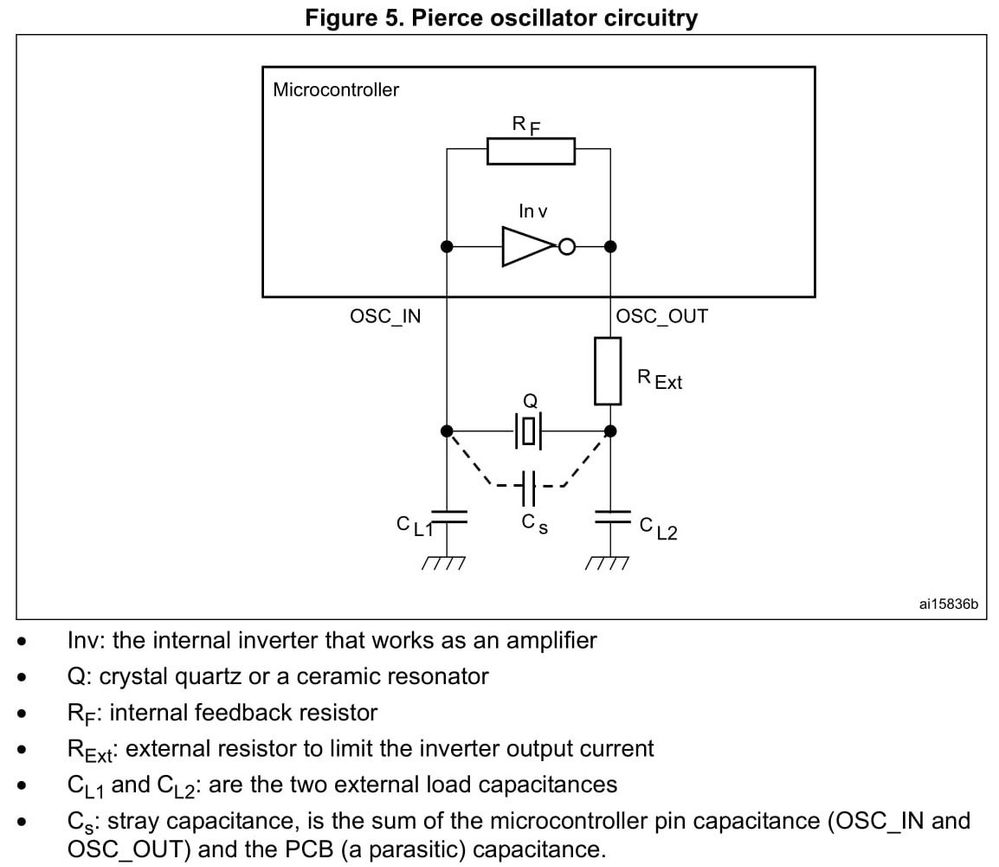

Depending on the datasheet of the STM32WB55 MCU, there is an external resistor for the oscillator circuit. In many Nucleo board schematics, it is not used. The datasheet says that the resistor is to avoid overdriving current.
How can I decide that overdriving or do I have to limit the current? Does not the MCU limit the current?
The schematic in the attachment is from the STM32WB Nucleo Board.

They dont use Rext in the STM32WB Nucleo Board design because they chose a XTAL whose current requirements were met by the microcontroller pins. (same with every XTAL ive seen in STM nucleo/discovery boards)

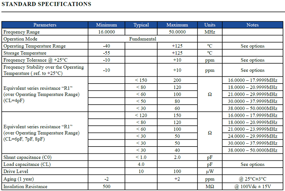

Hello Javier,
Thank you for the comment.
The XTAL that I want to use is "ABM8W-32.0000MHZ-7-D1X-T3". Its link is that.
Its specifications are below
I see your problem now, all STM datasheets say every STM HSE circuit has a builtin RF resistor.
They dont say the value at all.
I dont have an answer for you
Well... what about trying your design without the Rext? Or playing safe and use the XTAL they use in the nucleo board?
