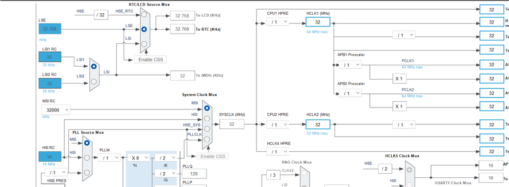

I made a breakout board using the STM32WB5MMG with SWD debugging.
I have confirmed that the SWD pins are working.
I have also set up HSEM, IPCC, RCC, RTC, RF, STM32_WPAN required but I can't detect the Bluetooth
The following are clock configuration.

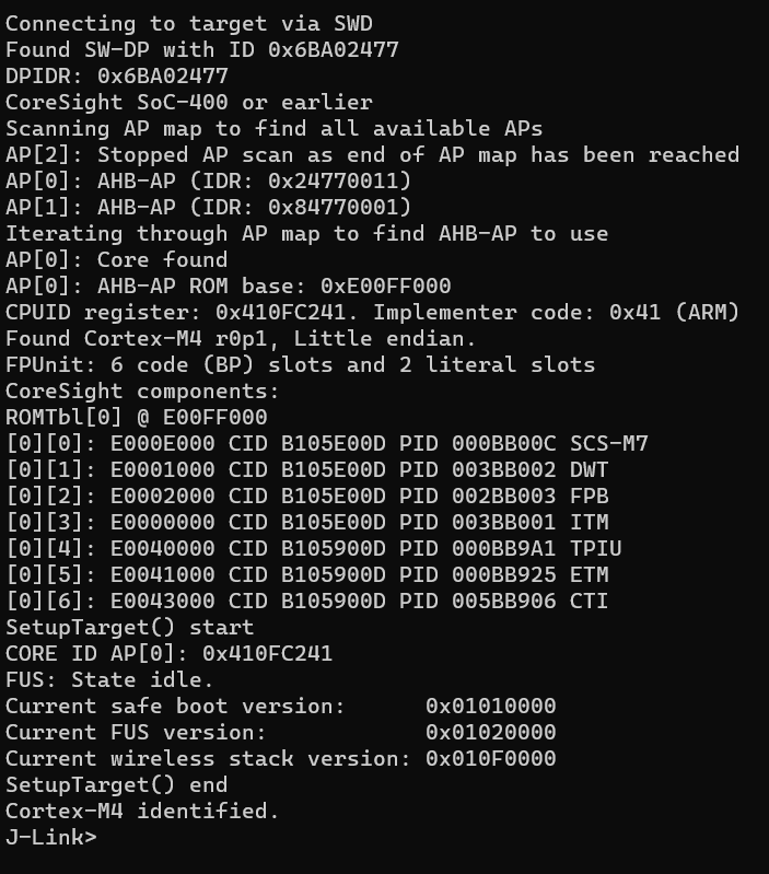

‎2022-12-11 1:30 AM
Hi @Lotta​ ,
I follow the guidelines on :
- https://wiki.segger.com/ST_STM32WB#Acquire_Wireless_Stack_binaries
- /Respository/STM32Cube_FW_WB_V1.15.0/Projects/STM32WB_Copro_Wireless_Binaries/STM32WB5x/Release_Notes.html
For Firmware (V1.2.0):
stm32wb5x_FUS_fw.bin at address 0x080EC000
For Wireless (V1.15.0):
stm32wb5x_BLE_Stack_full_fw.bin at address 0x080CE000
The following shows the J-Link Commander:
‎2022-12-12 12:19 AM
Hi @SWong.10​ ,
I too struggled with the same issue, that is why I asked for your firmware. There seems to be a bug in the new 1.15.0 version of the firmware.
https://community.st.com/s/question/0D53W00001zO6wXSAS/bug-for-ble-init-in-new-wb5-firmware-115
I described how I debuged and what the bug is here. Maybe you can debug as well and see if it is the same problem.
If you have the same issue, the only thing that helped me was roll back to the 1.14.1 firmware. There everthing works perfectly.

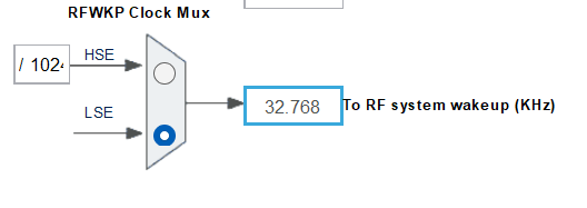

Sorry for the late response due to personal reason. The problem has been solved.
STM32CubeIDE Version: V11.1.0
Follow the guidelines on :
Remember to make sure that the wireless stack is started.
The problem I faced was the clock configuration for RFWKP Clock Mux. Previously, LSE was selected but the Bluetooth did not work. Thus, using HSE instead of LSE for the RFWKP works for me.
