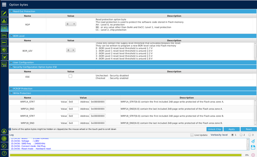

I have new custom board on STM32WL55CCU7. I can't flash/program with STM32CubeIDE.
And when i try to connect with STM32CubeProgrammer with "Normal'" mode I have this error :
"Error: Cannot connect to access port 1! If you are trying to connect to a device with TrsutZone enabled please try to connect with HotPlug Mode"
 14:23:09 : ST-LINK SN : 002900213431511631343632
 14:23:09 : ST-LINK FW : V3J10M3
 14:23:09 : Board      : STLINK-V3MINIE
 14:23:09 : Voltage    : 1,78V
 14:23:09 : Error: Cannot connect to access port 1! If you are trying to connect to a device with TrustZone enabled please try to connect with HotPlug mode.
And if i try to connect with "Hot Plug" mode I have this :
 14:19:28 : ST-LINK SN : 002900213431511631343632
 14:19:28 : ST-LINK FW : V3J10M3
 14:19:28 : Board      : STLINK-V3MINIE
 14:19:28 : Voltage    : 1,79V
 14:19:28 : SWD freq   : 1000 KHz
 14:19:28 : Connect mode: Hot Plug
 14:19:28 : Reset mode : Hardware reset
 14:19:28 : Device ID  : 0x497
 14:19:28 : Revision ID : Rev Y
 14:19:28 : UPLOADING OPTION BYTES DATA ...
 14:19:28 :  Bank         : 0x00
 14:19:28 :  Address      : 0x58004020
 14:19:28 :  Size         : 96 Bytes
 14:19:28 :  Bank         : 0x01
 14:19:28 :  Address      : 0x58004080
 14:19:28 :  Size         : 8 Bytes
 14:19:28 : UPLOADING ...
 14:19:28 :  Size         : 1024 Bytes
 14:19:28 :  Address      : 0x8000000
 14:19:28 : Read progress:
 14:19:28 : Data read successfully
But I can't do a Mass erase, i have this error :
"Error : Mass erase operation failed. Please verify flash protection"
Any idea why please ?

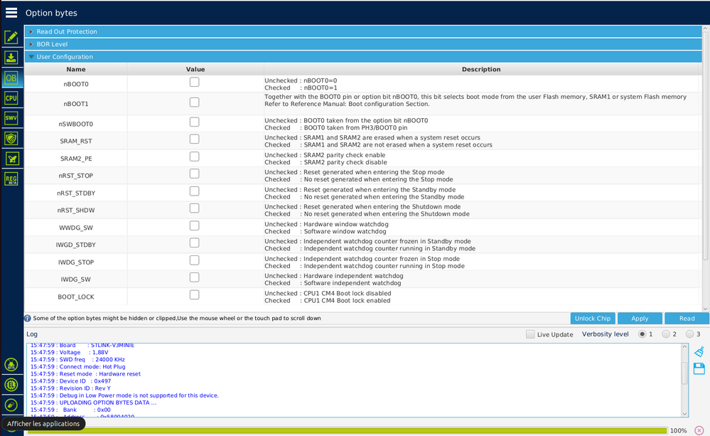

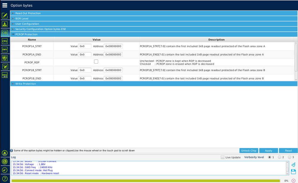

Here this what I have on OB Menu. RDP is set to 00, on SDK we have AA.
If i try to change to AA, STM32CubeProgrammer get stuck and crash on Linux (version v2.12.0) and STLIN-V3MINIE (version V3J10M3 STM32 Debug + VCP)
I have never program it, and all my board are in this state.

the OB don't look healthy. It looks like the tools read all zeroes, which is not a default state and not even a valid state.
You are correctly trying to get the RDP to 0xAA value, this should normally trigger the regression and put the product to RDP0. Reading 0 in the RDP OB should be interpreted as RDP level 1, which should allow regression. I'm not aware of any exception.
I never encountered a situation where the STM32CubeProgrammer would crash, so this is really unknown territory for me. In your place it'd probably try using alternative tools. For example STlink v2, Windows machine, even the legacy ST-link Utility, the predecessor of STM32CubeProgrammer should support STM32WL (but probably not stlink v3).
