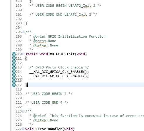

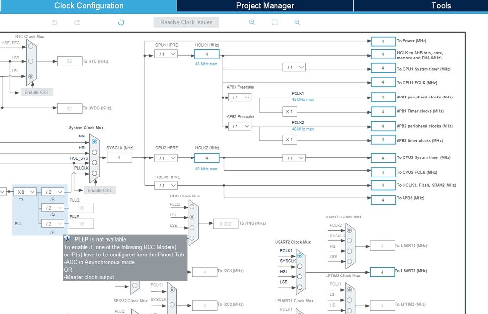

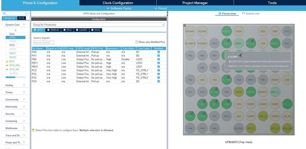

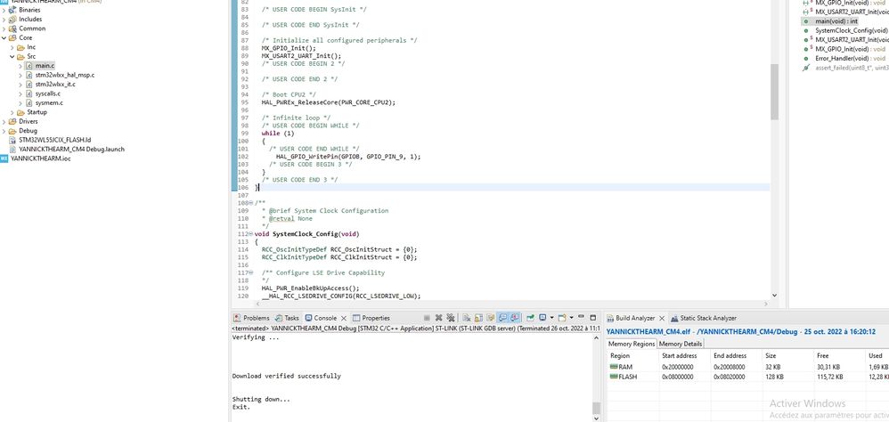

0693W00000VO8rjQAD.jpgHello, I just received my WL55JC2 card and I would like to blink one of the leds on the card with a very simple line of code but I don't understand why it doesn't work. I noticed that the led was pinned on the GPIOB which was not enabled in the generation of my code.
Here are some screenshots to help me. Thanks
