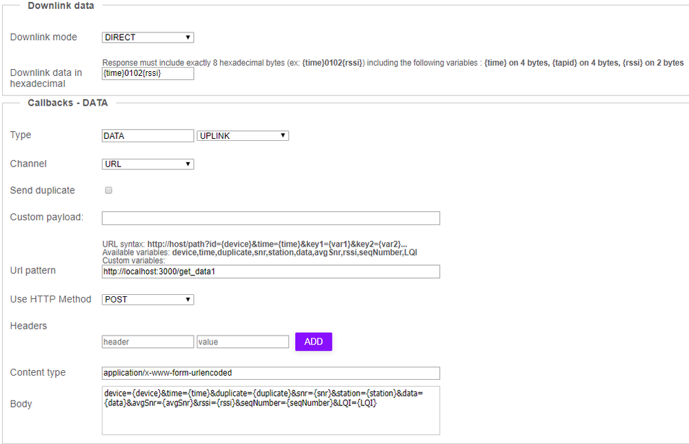

I currently run a application with B-L072Z-LRWAN1 Discovery kit.
I use sample code STM32CubeExpansion_SFOX_V1.1.0/Sgfx_push_button. In this project have:
SIGFOX_API_send_frame(ul_msg, ul_size, dl_msg, nbTxRepeatFlag, SFX_FALSE);
	PRINTF("----Respose----");
	for (i=0; i < 8; i ++){
		PRINTF("%02X ", dl_msg[i]) ;

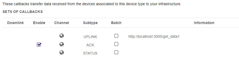

When i send message to Sigfox Network Emulator. SNE can read message and show it into web. I already set callbacks function in SNE as bellow:
As I know, with config of callback. When SNE receive message from KIT, SNE will send downlink message that has content {time}0102{rssi} to KIT. But when I print dl_msg, just has 00 value like that:
wakeup OK
devId=FEDCBA98
devPac=0000000000000000
send data....00 01 02 03 04 05 06 07 08 09 10 11 ----Respose----00 00 00 00 00 00 00 00 done
