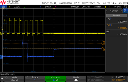

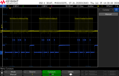

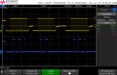

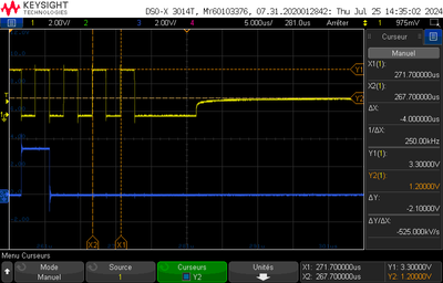

For those who saw my post about SD card and FileX, I am still on that subject and encountered an issue about SPI with the STM32WBA52CG MCU.
A Cube project is available attached to this post as a simplified example of SPI communication.
While using SPI1, the clock signal outside communications is at 1.2V instead of th precedent state 0 (0V) or 1 (3.3.V)
as shown in those oscilloscope screenshots:
While using SPI3 as I thought it might not show that behavior, another strange behavior appeared, this time on the MOSI signal with a constant voltage when outside com. at 1.9V:
I suspect this behavior to be at least partly responsible for my failure at communicating with an SD Card. (btw if you have some hints on that part I would be grateful :) )
Is this related and is the cause of my lack of com. in my SD card/FileX project, does it have an impact on communication, and is it simply a bug or am I responsible for something?

Hello @Curious_Intern ,
Could you please enable FileX usnig CubeMX in your application ? I have reviewed your attached project and noticed that the FileX files are not visible.
Also, I would recommend using pull-up resistors for SPI signals (SCK, MISO, MOSI). This can help ensure proper signal integrity and reliable operation.
