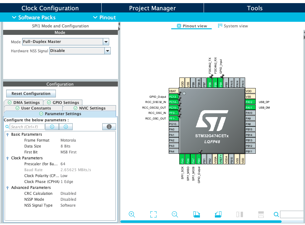

Hello. I am using W25Q128JVSIQ for flash storage. I am curious if anyone has run into this or a similar issue with using the flash chip with standard SPI.
1: I can program page 0 up to 256 bytes without issues.
2: I can then program page 1 up to 255 bytes without issues.
3: If I program page 1 with 256 bytes, all of the remaining pages (2, 3, 4...) have the same data as page 1 (without any additional programming).
4: if I program page 2 with any data, the page 2 data overwrites page 1 data. And remaining pages have the same data as page 1.
Anyone seen this type of behavior before?
ASCII written to page 0, 1, 2

STM32G4 setup.

‎2024-10-11 2:02 PM
No, this is all you.
Make sure you've got the address width right, these would be 24-bit addressable devices, not 32-bit
Dummy / Alternate cycles? On reads, probably more salient on QSPI / OSPI HW
Show the actual code doing the w25qxx interactions
Addresses must be aligned, you must wait for the PAGE WRITE to complete.
What do SR1 / SR2 contain?
‎2024-10-11 2:34 PM
SR1 = 0x00, SR2 = 0x02. I am using Lars Boegild Thomsen's files (with modifications) to erase, write and read (24 bit address). https://stm32world.com/wiki/STM32_W25Qxx
1: Erase sector 0
2: Write at address 0, 256 bytes. (I copy the bytes in to serial program that sends the data to micro-controller, good second or two between each page writes.)
3: Write at address 256, 256 bytes.
4: Write at address 512, 16 bytes.
5: Read back data from page 0 to 15.
‎2024-10-15 6:49 AM
