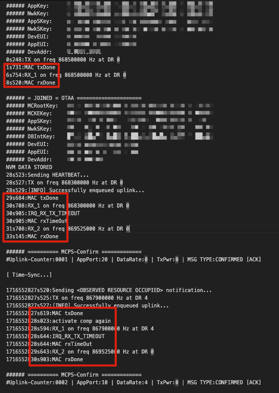

I tool a closer look at the timings and was wondering:
a) It looks like RX1 window is opening 2s after beginning of TX transmission. Shouldn't it be after the end of the transmission?
b) Why is the RX window increased by the LNS?
1715603464s576:TX on freq 868500000 Hz at DR 0
1715603465s732:MAC txDone
1715603466s575:RX_1 on freq 868500000 Hz at DR 0
1715603467s101:IRQ_RX_TX_TIMEOUT
1715603467s101:MAC rxTimeOut
1715603467s575:RX_2 on freq 869525000 Hz at DR 0
1715603468s101:IRQ_RX_TX_TIMEOUT
1715603468s101:MAC rxTimeOut
BTW, the OTAA join seems to be closer to "5s from end of transmission", and also works a lot more reliable
0s030:TX on freq 868100000 Hz at DR 0
1s488:MAC txDone
6s331:RX_1 on freq 868100000 Hz at DR 0
8s160:MAC rxDone
###### = JOINED = OTAA =====================

After reverting to 20ms, I see that it moves closer to "Rx delay after end of transmission + RxError window".
Also, receive window opens now 1s after txDone, but LNS sends after 2s...

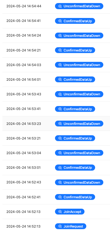

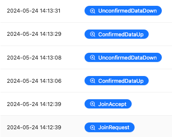

Ok, here's a situation where almost everything worked (OTAA join on first try, downlinks ACKed), but in the first downlink, LNS sets RX delay to 2 seconds, but RX1 is still opened after 1s.
Heres the first UnconfirmedDataDown
Here you can see, OTAA is 5s + 20ms RxError
First downlink is expected 1s + 20ms RxError
Second downlink should be 2s, but is still 1s (strangely MINUS ±20ms RxError?)

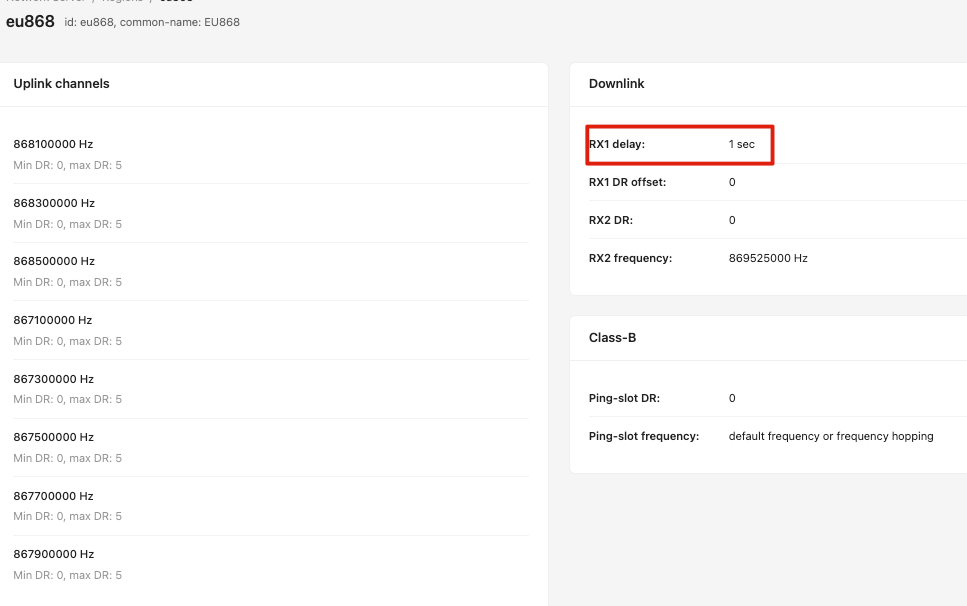

Strangely ChirpStack settings also tell me 1s RxDelay
But in general, RX_1 always times out and RX_2 comes to the rescue, but this should not be the standard behavior I guess...
2024-05-24 05:58 AM - edited 2024-05-24 06:03 AM
And then there are situations where this goes just on and on with NACKs. OTAA most of the times works after some tries. This is with RSSI ±-60 and SNR of 8.8.
This took 11 tries to get an ACK here...
Is it possible they are not delivered by the gateway because of Duty Cycle restrictions?
