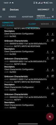

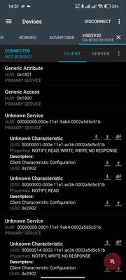

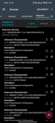

 I expected to get services listed by nRF Connect app.
photo_1_2026-04-03_17-44-41.jpgphoto_2_2026-04-03_17-44-41.jpgphoto_3_2026-04-03_17-44-41.jpg
But the program output is empty. Why?
PS: I have done some research and experiments. I have tried running same script on linux and it ran perfectly (I used 2 machines: same machine (dual boot) and raspberry pi). I have noticed that board crashes if you are trying to pair with it. And does not give you services(does not respond) if you are not pairing, because of MITM_PROTECTION_REQUIRED BlueNRG2 just drops packages and Windows hangs indefinetly. If you pair with the device, Windows Bluetooth stack just bombards mcu with a ton of concurrent requests and board crashes. I think increasing bluetooth task queue might help? Am I doing something wrong?

To verify BLE functionality, I used my smartphone as a bluetooth device, and I was able to retrieve services and characteristics successfully (see attached screenshot).
Based on this, it seems the firmware is running, but the issue may be related to how commands are sent from Windows or how the board handles them.
