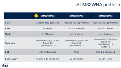

If I develop an application using the STM32WBA25 MCU with BLE, ThreadX, and USBX, is the RAM size sufficient?

96KB looks like decent amount of RAM  - but RTOSes such as ThreadX require a lot of RAM for thread stacks. So it highly depends on the number of your tasks/threads.

Given that my application includes approximately 3 KB of historical data, a CC protocol using the FUSB302B, and a USBX CDC stack requiring at least 12 KB of memory, would you recommend continuing development with the STM32WBA25 series?

Previously, I used the STM32WBA62 MCU, which provides a large RAM capacity, allowing flexible memory allocation. However, when using the same configuration on the STM32WBA25, I must carefully optimize memory usage to ensure the program fits within the available RAM. Therefore, I want to make sure the RAM size is sufficient before designing the MCU into my project.

You can find more information about STM32WBA memory requirement and consideration on the wiki page:
STM32WBA Zigbee/BLE memory requirements

Thank you for your response. I would like the MCU to support both BLE and USB functionality. Currently, only the WBA2x and WBA6x series meet these requirements. Considering functionality and cost, the WBA2x appears to be the preferred option. The only remaining concern is the RAM size. To mitigate this risk, I plan to design and fabricate a test board to evaluate overall system stability.

You are right. Both STM32WBA2x and STM32WBA6x series support BLE and USB:
STM32WBA2 wireless MCU series overview
Regarding the RAM size, validating with a dedicated test board is the correct approach. This will help ensure the application fits within constraints and allows you to assess RAM usage.
