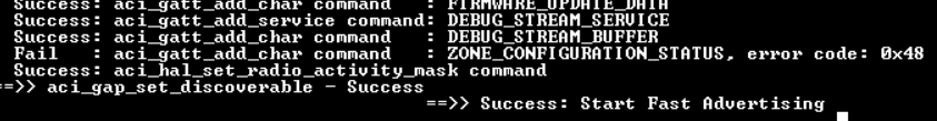

- The maximum number of characteristics for a given service is restricted to 5. I browsed through some of the community posts and got to know that I can add more characteristics with the help of 'aci_gatt_add_char()' function. But while doing this the function is returning the error code 0x48(attaching the debug photo). What is the meaning of this error code?
- When the services get initialized, there is a parameter 'Max_Attribute_Records' which is sent as an argument for the service. Is there any way that the developer can change this number so that the above mentioned point number 2 can be achieved?

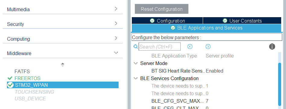

- The project has also requirement to add RTOS middleware. When I enable the RTOS, the custom server template is not available. Only the SIG HeartRate profile is provided for the user. Is there a way to have Custom server template along with the RTOS. (attaching the snapshots from the CubeIDE)

The limitation to 5 characteristics for 1 service comes from STM32CubeMX tool, indeed you can add more characteristics with the aci_gatt_add_char() function, to do this you should increase the Max_Attribute_Records parameter used in aci_gatt_add_service() function. To calculate this parameter follows this formula:
Max_Attribute_Records = 1
+ 2*no_of_char
+ 1*no_of_char_with_notify_or_indicate_property
+ 1*no_of_char_with_broadcast_property
The error code 0x48 means Out of memory.
STM32CubeMX tool supports only the SIG HeartRate profile with the RTOS, to port your project on FreeRTOS, you can look the difference between BLE_HeartRate and BLE_HeartRateFreeRTOS.

"STM32CubeMX tool supports only the SIG HeartRate profile with the RTOS, to port your project on FreeRTOS, you can look the difference between BLE_HeartRate and BLE_HeartRateFreeRTOS."
Will STM32 configuration custom templates be supported while using FreeRTOS in the near future? What is the major issue with this... it would seem to be a simple coding of adding a new process for each BLE service needed. Or is there something more complicated going on here?
