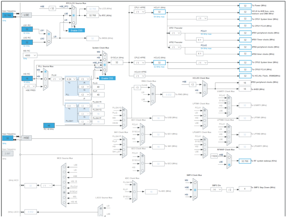

Clock config (sorry for poor resolution):

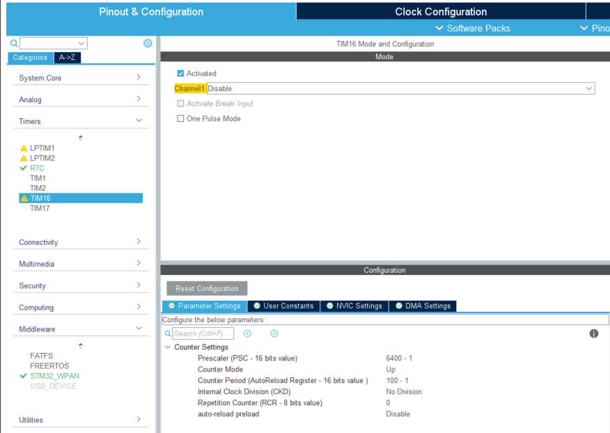

I've done some digging around on in the forum. It seems the Hardware timers is a viable substitute for the Hardware-Time-server - My application is not using all of them.
I'm getting the results a want with (periodic notify that updates a characteristic):
Logic:
/** In custom_app.c **/
void Custom_APP_Init(void)
/* USER CODE BEGIN CUSTOM_APP_Init */
	// Register additional tasks - eg for notify
	APP_DBG_MSG("\n**APP INIT BEGINING**\n");
	UTIL_SEQ_RegTask(1<<CFG_TASK_SAMPLES_NOTIFY, UTIL_SEQ_RFU, vibration_sample_action );
	// register timers - for notify callback
//	HW_TS_Create(CFG_TIM_PROC_ID_ISR, &Custom_App_Context.Update_timer_Id, hw_ts_Repeated, Sample_update_callback);
	// Init the context
	Custom_App_Context.Sample_not_value.Max = 0xFF;
	Custom_App_Context.Sample_not_value.Min = 0x00;
	Custom_App_Context.Sample_not_value.Value = Custom_App_Context.Sample_not_value.Min;
	Custom_STM_App_Update_Char(CUSTOM_STM_VIB_SAM, DUMMY_DATA);
	APP_DBG_MSG("\n**APP_INIT FINISHED!**\n");
/* USER CODE END CUSTOM_APP_Init */
  return;
/* USER CODE BEGIN FD_LOCAL_FUNCTIONS*/
void HAL_TIM_PeriodElapsedCallback(TIM_HandleTypeDef *htim){
	if (htim == &htim16){
		// callback to SAMPLE_NOTIFY_CHARACTERISTIC enabled
//		APP_DBG_MSG("\n## Sample_update_callback() ##\n");
		UTIL_SEQ_SetTask(1<<CFG_TASK_SAMPLES_NOTIFY, CFG_SCH_PRIO_0);
static void vibration_sample_action(void){
	NotifyCharData[0] = Custom_App_Context.Sample_not_value.Value;
	++Custom_App_Context.Sample_not_value.Value;
	NotifyCharData[1] = Custom_App_Context.Sample_not_value.Value;
	if (Custom_App_Context.Sample_not_value.Value > Custom_App_Context.Sample_not_value.Max){
		// reset
//	Custom_Vib_not_Update_Char();
	Custom_Vib_not_Send_Notification();
/* USER CODE END FD_LOCAL_FUNCTIONS*/
Timer configuration:
0693W00000Bbf6IQAR.png+ TIM16 --> NVIC Settings --> Enable interupt

Hello @KMeld.1​ ,
In order to check if there's an issue with the clock, could you configure the MCO pin to output the clock and view it in a scope. If there's a perturbation it should be (after some looking around) visible there.
Maybe @Remi QUINTIN​  can provide some more hints regarding this case.
