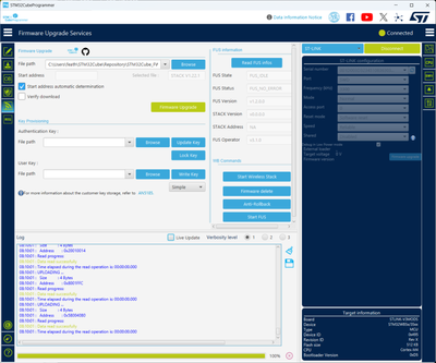

I'm having the same problem.   I have been programming my product successfully from repository STM32Cube_FW_WB_V1.22.0, but I'm trying to set up a new windows computer for production programming and I downloaded the repository and got STM32Cube_FW_WB_V1.22.1.
I changed the script for the new directory, and it can find the stack_full file file and it downloaded it successfully, and verified it, but then the fus gives me the same error message as that previous user had.
So I tried doing it with the GUI version and I got the same result.   It found the file, downloaded it, verified it, but then couldn't complete the upgrade.    I did a full chip erase and tried again and got the same result.

This is using the GUI's new start address automatic determination.   I also tried it using the start address that has been working for me before, 0x0805A000, and I could see it was erasing sectors 90 to 121 instead of 92 to 123, but I got the same result.
Here is what I get when I read the FUS
I tried again using the other repository I had downloaded, 1.17.2, and it worked.   I noticed that it was programming sectors 90 to 127 with that stack using the start address automatic determination.   I think there is something wrong with the 1.22.1 full stack binary.
